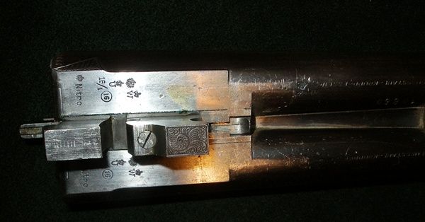

Here are the proof marks. Is it me or do those marks look unusually fresh, compared to the wear at the end of the barrel flats?
Posts: 12,849
Posts: 12,849
Lovely rectangular crossbolt and something interesting in the crossbolt well; maybe just a tool mark? I'd say a tradegun as the water table wears no serial number. I guess a maker made a brace, sold one to a firearms merchant in Berlin and peddled one out the back door to a customer. A serial number of sorts toward the forend hanger and some Krupp steel variant recipe. Possibly a few touchmarks there but the dim lighting limits the view. Standing breech may wear a touchmark. Made in Suhl between 1912 & 1923 with a higher probability closer to the end of the range.

Thanks Raimey - I really appreciate all the input. This sure looks to be a well-made gun but am trying to figure what to make of the lengthened chambers.
Posts: 12,849
Posts: 12,849
1st I would want to see an image of the face of the extractors/ejectors to see if there is a 70(mm) there. Times were difficult during this period and possibly it was intended for a Taubenflinte and then the mechanic altered the sporting weapon to the customer's whims. Again, I suspect that the forcing cones are long and there is user error in the chamber length measurement. Definitely an upper rung tradegun with hidden rectangular crossbolt, sideclips, sideframe reinforcement, etc. which again would point to a Taubenflinte with ejectors. Is the safety automatic or manual?

Ah, I should have typed Taubenflinte/pigeon. Yeah, at 6 lbs it is a bit light but it has all the characteristics of a Taubenflinte. A chopperlump tubeset is the exception in Suhl. It may be that more chopperlump tubeset originated from the Zella-Mehlis region than Suhl. I consider it a very good deal as I don't think you could get an O. Geyger for double that price. And it just reeks of quality. 2 5/8" is more like it and it memory serves me right(please correct me Mike Ford if I'm wrong) that for scattergun chambers a 5mm difference in the longitudinal direction would warrant a stamp of the next dimension. So a 65mm chamber could be a bit longer and still be considered a 65mm. Or it may have been that most were closer to 67.5mm than 65m and it was when a chamber exceeded 67.5cm that the stamp switched to 70mm. Ford has told me and I didn't pen it on the back of my hand. Also past 70mm, there was an equation for pressure increase per 5mm.
Anyway, I'll say that at a distance you could put this one beside a similar O. Geyger and practically no one could resolve the difference.
Post some images of the marks from the area forward of the flats to the forend hanger if you get a chance.
