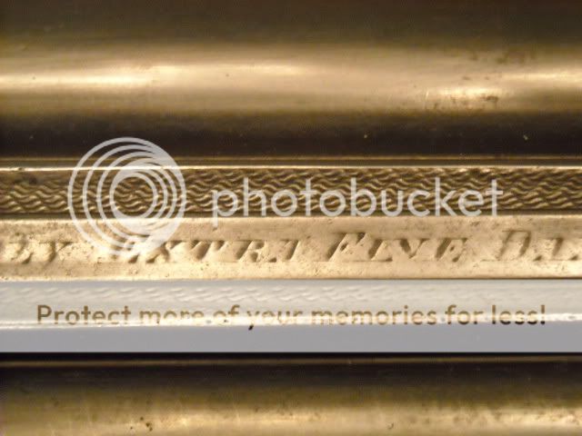

--Charles Daly Extra Fine Damascus Barrels Diamond Quality is engraved on the top rib.

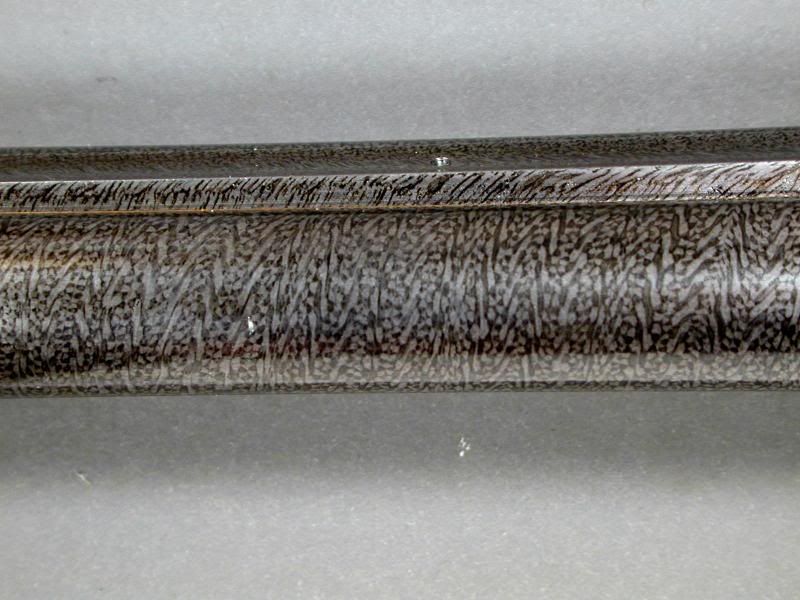

The barrels should look like this Toncin pattern - in browned
Black & white

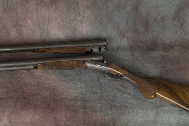

Well, I am back a little earlier than expected from my meetings in central Tx. I am posting these picturs so that others can see and hopefully provide more information. I apologize, I am not the best picture taker. If I need to take another picture of another part of the shotgun, please let me know. I guess we'll never know who "LE" is stamped on the barrels. Ken Georgi, pm has been sent to you.

Hi Red- The grip cap I mentioned is a small blob of horn on the bottom of the half pistol grip. Ours differ in the engraving pattern and tear drops. That on mine is a much finer scroll with partridge on the frame bottom and a realistic setter on the trigger plate. Ducks on the trigger guard. The checkering is so fine my old eyes can't count the lines per inch- not less than 28-30 lines per inch. I've never seen such small diamonds. Pointed, not flat. All in all, fine guns. Over on Not SSM BBS, Pooch has found still yet another much like these. The economy seems to have shaken a few out of the wood work.

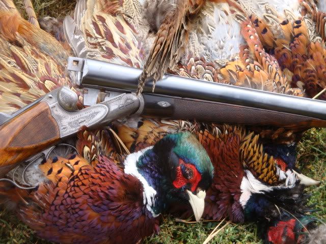

I own the Lindner that Doug Mann restocked and when i get back from hunting today will post some photos of her and both sets of barrels.
If it is any interest, I am hunting today and have done so all season with a Lindner FW. She weighes a scant 5 pound 9 ounces and is as deadly as a viper and twice as fast as a harlot. To date she has put season limits of pheasants from three states in the freezer with but two misses.
I have far more fine doubles than a man should be allowed, but I just can not bring myself to use one of them instead of her.

OK, I am back from my morning's hunt. The little Lindner put three nice birds in the bag that are as I type, marinating in yogurt in preparation for the grill this evening. Here is a photo of the FW and the Diamond grade I bought from Doug.

Bob: to my eye, those "Turc Extra" or Extra-fine 4 Iron Turkish "Star" pattern barrels are the most attractive damascus produced. Note the alternating 'stars' of black (iron) and white (steel) between the symmetric scrolls.
This is Dr Gaddy's example from his Pattern Board
Could you please post high resolution ultra close up images, or send by jpg attachment to revdoc2@cox.net and thanks!
Drew
And I believe redoftx will find a spectacular herringbone pattern underneath the blueing.

Drew,
Here's a couple of photos of Bob's barrels that I found in my Photoshop album.
Doug Mann

Drew, Which set of barrels are you looking for ???? The one you posted is the etched set the ones I posted are the second set of barrels.
Doug

I have to admit that some of the details on the gun were not what I expected to see. The markings on the gun (serial #, initials, brevete mark, Lindenr marks, etc.) and the general features on the gun (horn forend tip, cocking indicators, etc., etc.) are all what I would expect to see on a gun of this vintage. That said, the engraving and wood work on the butt stock seems out of place.
The subject matter of the engraving is correct (rae deer, pointing dogs, etc.), but all the fine detail is gone. On second look, maybe that detail was buffed out during a poorly thought out refinishing job and only the heavier portions of the engraving remain? Again, the animal shapes are there but not the detail.
Similarly the wood that is visible in the photos next to the action is either a replacement or has been crudley recheckered at a minimum. Prussian Dalys were notrmally very nicely stocked with close tolerances and attention to detail. The remains of the drop point has been hacked on by someone.
My comments are not intended to run the gun down; please take them in the positive sense they are intended. It looks like the gun has quite a history. I would not be surprised to hear it was fowling piece of serious duck shooter.
