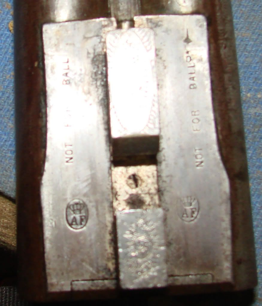

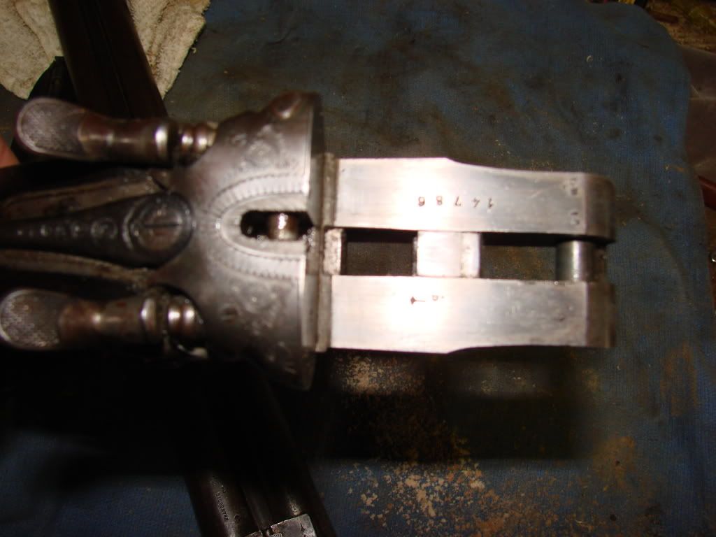

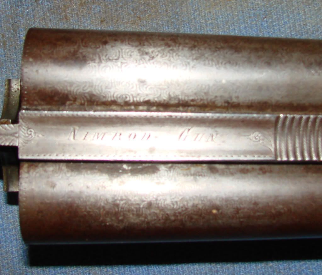

Hi Guys,
Looking for some information on a gun my Uncle recently traded some old milk bottles for.The gun is a Francotte 12 ga. He says it has Nimrod and Damascus stamped on it, and he thinks the serial number is 14786. It also has not for ball stamped on it. It has double hammers and scroll work over almost the whole gun. I will be going to have a look at it tomorrow and post some pics. He nor I have any idea what he has and would appreciate any help.

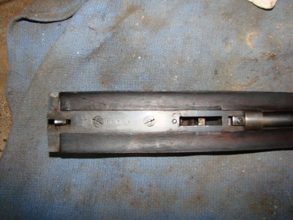

Here are your pictures:
OK, from the proof marks, the gun was made between 1878-1897. That is the range for "Not for Ball", which basically means the gun has some choke. The Crown with AF is the Francotte maker's mark.
http://damascus-barrels.com/Belgian_All_Proofmarks.html
http://damascus-barrels.com/Belgian_Trade_Marks.html
From the serial number, according to this list:
http://www.doublegunshop.com/dgsnos2.htm
The gun was made in 1889.
