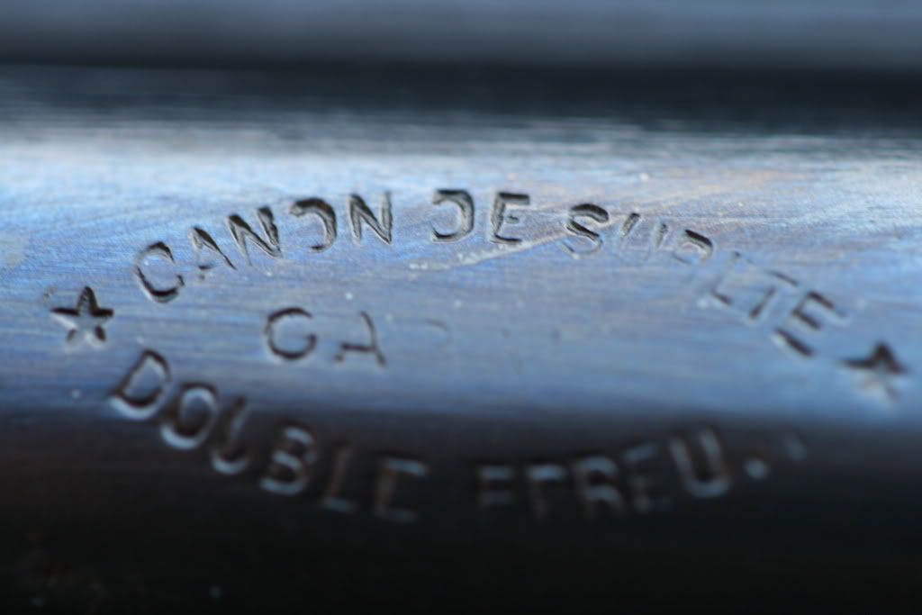

I think I found out what this means. I found this pic by chance and it seems to fit. Just I know that there is one more letter after the N in "CANON"
"CANONN DE DURPIS" over "NARANTIE" over "?????? ???????"
"Canon De Surete" over "Garantie" over "Double Peruffe"

Canon de Surete translates as "safety barrels". Often seen on French guns. Double epreuve is double proof, which means it was proof tested with higher pressure loads than a standard proof. That's a good thing.
Pricing French doubles is pretty tough. Good shots of the wood (stock and forend) would help. A better shot of the barrel flats--the underside, under the chambers--might help us decypher some more of the French. Good shot of the receiver to show the engraving.
