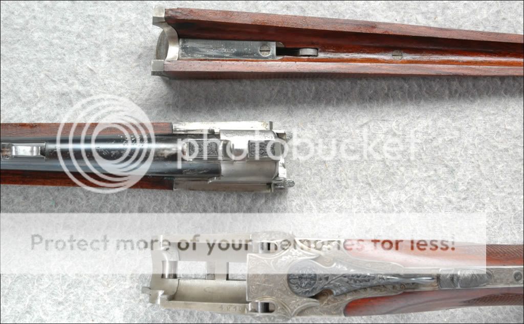

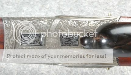

I have one of his drillings my father brought back from WWII and I have to say it's one of the nicest looking guns I have ever seen. I was wanting some information on him and the types of guns he made and how they are considered by today's standards. Gun is heavily engraved and has a lot of proof marks inside the receiver area with his name on top of the top barrel, it's (I believe) a 16 gauge on top and a 6.5MM on the bottom. Beautiful gun. Rick
Rick
RickD #184016 03/26/10 05:37 PM
Joined: Mar 2010
Posts: 7
RickD Offline OP
Joined: Mar 2010
Posts: 7
[img]http://s915.photobucket.com/albums/ac358/bdonova/Robert%20Schuller/?start=all[/img]
This is a link to the pictures of my Robert Schuler gun.
Rick

I did not see a "drilling" in the photos, unless somehow I was mis-directed to different photos. What I see is a combination gun, one shotgun tube and one rifle tube. That's not a "drilling." Looks nice enough regardless, certainly not spectacular by any means, has a few issues it would appear, but overall a nice combo gun and worth of not only adding to a collection of such guns but also determining the exact round to put it back into use. Likely a 16 gauge 2 1/2" shell,but the rifle tube is hard to read, almost looks like it says 8mm, perhaps an 8 x 57R, using a 196 gr bullet. Someone with a better photo editor and better eyes can be a better judge of that. Proofed in 7/26 it looks like. A chamber cast is certainly in order to make that determination. These German combo guns are commonly very good shooters. I have a couple that are very similar and absolutely love to hunt them. If you get tire of it and want to trade for something more functional, look me up.

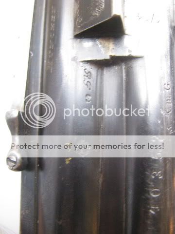

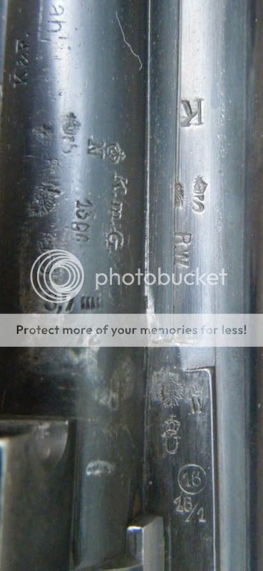

Krupp Cast steel tube but Wilhelm Kebler.
Same "RL" initials as on another current puzzle. "23" looks to be the assembly number and on the 2nd pic I posted is there another "23" with a "m/m" stamp above the "Crown" over "G"? My first guess is E. Schmidt & Habermann but there were others who were sourced.

E. Schmidt & Habermann were makers to the trade by I can't say that they didn't sub work to other craftsmen. I don't know who was E. Schmidt & Habermann's frame filer, or contract frame filer, but I almost can say that they mini-clamshell frame side reinforcement is a hallmark of E. Schmidt & Habermann.
With the non-script "Nitro" stamp, I'd guess it passed thru the Suhl proofhouse which really doesn't nail down "RL", or whatever, to a specific location. I guess it was just as easy to submit to one proofhouse as the other but I would garner a guess that most clients wanted the Suhl version.

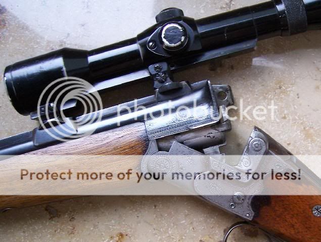

I bought an old BBF combo ("vertical cape gun") in Germany back in December. Very little info, no picture, but the price was modest at about $300 so I took the risk. The gun came here today. It looks almost exactly like RickD's. Unmarked outside but marked WK in script on the barrels (Wilhelm Kelber?). Proof date 5/26 (?- a bit fuzzy) for May 1926. Serial number 15012. Rifle barrel marked 7.8/57 and 15g so 8x57 IR as marked on the sale papers should be correct; shotgun barrel is the usual 16g 65mm.
The frame is almost same as RickD's except two details: on mine the upper part of the clamshell is more curved, and there is an extra small screw securing the front screw. There is a single Greener crossbolt, on the right side. Following Raimey's research this should be a Schmidt & Habermann or a Greifelt design if I understand correctly. As I remember I once saw the same type of action used on a Borovnik Ferlach BBF dated to the 1930s.

RickD's example.
An image similar to Jani's example
An image of an Anson-Kerner BBF combo similar to Jani's acquisition. Script "WK" would be Wilhelm Kelber so I wonder if he fitted the action. As I've stated before Axel Eichendorff holds that Wilhelm Kelber's script initials notes his making of the tubes and the "K" encircled by a heart shaped "W" notes the fitting of the action. I don't subscribe to that as of now. Somewhere on the tubes between the flats and the forend lug will be a set of tube maker's marks, probably a "K" encircled by a jagged image. I'm curious what the tube steel might be? With all the combos I'm curious if E. Schmidt & Habermann sourced Greifeldt for the frames as per their catalogues they offered quite a few O/Us usually with Boehler tubes? E. Schmiddt & Habermann is noted as a maker to the trade and I assume Greifeldt could have been but I haven't seen any info suggesting so. As usually more research is needed and I'm also curious what part the owners played and I think Paul was a master gunsmith. Was the Nitro mark in script? By the way these are of the Kerner - Anson & Deeley design being a rung or 2 about the triggerplate actions.
I mentioned earlier that I though that all Robert Schüler examples that I've seen were upper eschelon but upon reviewing my notes I did see a utility grade drilling at the 2009 Vintager's event as well as a double or 2 which were a bit about the utility status. Of course as usual I should have made better notes but I think the drilling had the initials "RS" on the underside which I would attribute to Richard Schüler and this assumption would strengthen the argument that Robert Schüler of Köln sourced Richard Schüler for his examples. But the same day I say the Robert Schüler drilling I also saw the Robert Schüler 600 Nitro clamshell and I guess it overshadowed the drilling.
