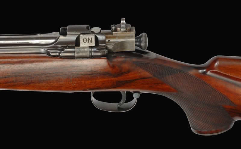

This rifle is marked on the barrel in one line "F. Surkamer, Chicago, ILL”. This rifle was built on a 1903 Springfield that was made in 1924 using a star-gauge barrel. The bolt shroud was replaced by a new one made with a built-in peep sight with a screw adjustment for elevation, drifted for windage. Also it is case hardened. With the removal of the bolt shroud which contained the military safety, a new safety was made and installed behind the trigger in the trigger guard. Both the safety and the new bolt shroud with sight show a high degree of workmanship. The rifle has a schnabel forend tip, engraved steel grip cap, banded ramp front sight and steel trapdoor buttplate. The layout, inletting, metal work, woodwork and checkering are first class. This rifle is as well made as many I have written about over the years and I am somewhat surprised that a person with this much talent was not better known. I would be very interested in learning about rifles or shotguns marked “F. Surkamer”.

Thanks, Michael. I was especially interested in the peep on the bolt sleeve and the fact that the upper tang had not been narrowed. The push-button safety is similar to some I've seen on G&H sporters.
Question: has the replacement bolt sleeve been especially fitted to return to 'zero', as in most of the high-quality bolt guns I've seen? For instance my early Jaeger 1903 has a hardened pin on each underside of its sleeve to allow the double-stage trigger to operate with a consistent pull action, and I once owned an H&H Mauser with a vee-notched sear that served to center its bolt-mounted peep. Anything like that here?

Another beautiful rifle for sure. I note that the early artists didn't believe much in leaving a gap behind the rear tang to avoid stock splitting. Many are tightly and perfectly bedded. If it can't move, it can't split I guess would have been their thought. Though later wood shrinkage from simple humidity changes, loose guard screws and damage from super lubs can destroy all that very quickly.
Michael an observation and a question.. Many of the early '03 Sporters like this one have the US markings and serial number removed from the receiver ring and then the area matted. I believe G&H even advertised that they would do this as a matter of course in building a standard rifle on the '03. Do you know at what point in time the removal of the serial number became illegal? Was it the Federal Firearms Act 1939? I read that G&H would restamp the ser# on the bottom of the barrel but moving a serial number around on a gun is not acceptable today either. Just wondering..they certainly look alot neater without the heavily stamped markings on top.

The Surkamer has two pins on the bottom of the sleeve ground for a tight fit. When the bolt is closed and in the cocked position it’s very solid. If I remember correctly there is no longer a two-stage trigger on this rifle. The Kirkwood has two pins and I believe that the Gibbs has two screws to keep things tight.

You are right, I would say that about 99% of the pre-war American custom makers inletted the tang tight and 80% of them are chipped or cracked. On the other hand look at the Gibbs they relieved the back a bit.
It’s my understanding that firearms did not require a serial number before the 1968 gun control act.
